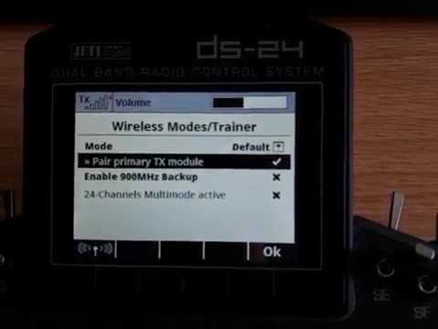

          3. in the transmitter menu activate pairing process (main menu/advanced properties/wireless modes/pair TX module = you must press the button even if the transmitter displays the running pairing process, it is important to reset the entire process)

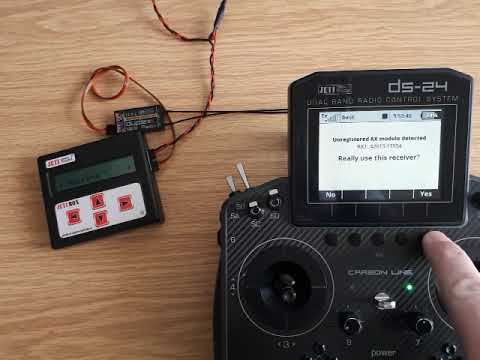

          1. Connect to the receiver (Ext. input) Jeti box
          2. connect the power supply to the receiver and set the pairing process in the Jeti box menu. When the pairing process is started, displays countdown time on the Jeti box, so you'll be sure that pairing is really active.

            Fikk noen videoer fra Jeti smamen med svaret på epost som viser de forskjellige binde metodene:
            Normal metode med bindeplugg
            Bindemetode ved bruk av Jeti Box
