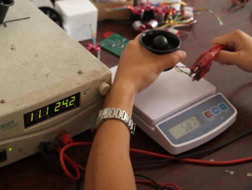

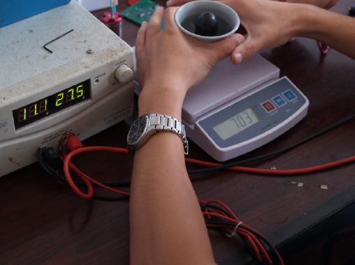

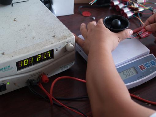

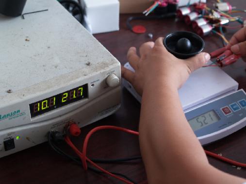

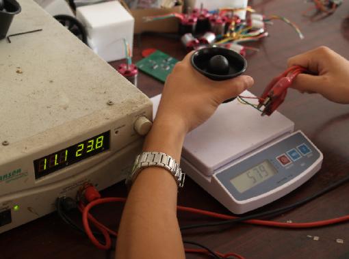

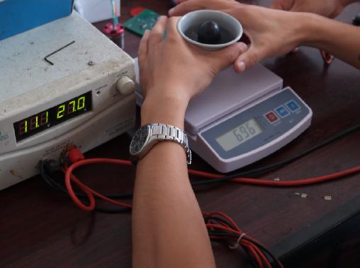

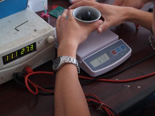

We test the EDF(AEO's DF64 and DF55) by blowing the scale.Although this way is not meticulous enough and can not show the max energy, the DF64 can provide more than 700g of thrust with 3S lipo.

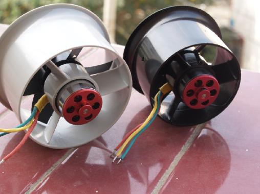

The following are some details and photos about testing EDF.
ADH300 DF55 (ADH300 3000KV)--Weight:59.5g
Testing Result
Volt : 10.5V
Current : 10A
Thrust :300g
Power : 105W
ADH300 DF55 (ADH300 3900KV)--Weight:59g
Testing Result
Volt : 11.1V / 10V
Current :15.8A / 13.8A
Thrust :510g / 420g
ADH300 DF55 (ADH300 4300KV)--Weight:59g
Testing Result
Volt : 10.5V / 10V
Current :23A / 21.5A
Thrust :510g / 498g
Power : 241W/ 212W
ADH300 DF64 (ADH300 3900KV)--Weight:64g
Testing Result
Volt : 10V / 11.1V
Current :16A / 19A
Thrust : 456.8g/ 535.8g
Power : 160W / 210.9W
ADH300 DF64 (ADH300 4300KV)--Weight:64g
Testing Result
Volt : 10V / 11.1V
Current :23A / 26A
Thrust : 612g/ 720.3g
Power : 252W / 288.6W
DF48 AD100 (AD100 4250KV)----(AD100=C10-L)
Testing Result
Volt : 7.4V / 8.4V
Current :4.7A / 5.6A
Thrust : 110g/ 130g
Power : 34.78W / 47.04W
DF48 AD100 (AD100 5200KV)----(AD100=C10-L)
Testing Result
Volt : 7.4V / 8.4V
Current :6.4A / 7.4A
Thrust : 160g/ 170g
Power : 47.36W / 62.16W
DF70 28XL-GTS (28XL-GTS 3300KV)---(28L motor can fit for 450 class helis)
Testing Result
Volt : 11.1V / 14.8V
Current :33A / 37A
Thrust : 780g/ 1070g
Power : 366.3W/ 547.6W
Testing Result
Volt : 10V / 11.1V /12.6V
Current :29.6A / 34A /39A
Thrust : 700g/ 815g /940g
Power : 296W/377.4W /491.4W
DF55 C20pro (C20 pro 3600KV)
Testing Result
Volt : 11.1V
Current :10.5A
Thrust : 345g
Power : 115.5W
DF55 C20pro (C20 pro 3900KV)
Testing Result
Volt : 10V /11.1V
Current :14A / 16A
Thrust : 350g /420g
Power : 140W /177.6W
DF55 C20pro (C20 pro 4600KV)
Testing Result
Volt : 11.1V
Current :20A
Thrust : 460g
Power : 220W
DF64 C20pro (C20 pro 3600KV)
Testing Result
Volt : 11.1V
Current :13A
Thrust : 420g
Power : 144.3W
