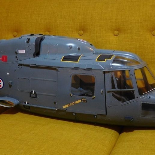

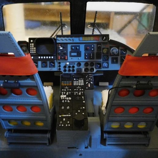

      300 g med cockpit og folk.
      Jeg har nå lagt ut dørene og cockpit på Cults3D:
      Also check out my other Vario Lynx parts in my profile. Sliding cabin doors and scale static cockpit doors for the Vario Lynx fuselage. Cabindoor01/2 - Right and left cabin doors with standard window location. Cabindoor01-mk88a - Special left hand cabin door with the window moved aft, as on some Lynx models (Germany Mk88a for example). Doorrail01 - Fairings over the cabin doors which build out to make room fot the C-shaped rails. Lowerrail01 - Lower rail for the cabin doors. Cockpitdoor01 - Scale cockpit door frames. The cockpit door frames need to be formed to fit the curvature of the fuselage after printing. I recommend cold forming. The main cabin door lower rail should be secured with #0 countersunk screws in the five lugs, and glue in the front. The main cabin doors need two #1 screws in the top which will slide inside the top C-rails. Use M2 screws to secure the door handles and emergency release handles. Video of door removal and installation: https://www.youtube.com/watch?v=mzDK6OaexA8
      Also check out my other Vario Lynx parts in my profile. Parts to build a convincing cockpit interior for the Vario Lynx fuselage. They are based on the Mk86 Lynx used by the Royal Norwegian Airforce from 1981 to 2014. Not everything is perfectly accurate. The cyclic and collective sticks are not accurate, and a couple of the components on the interseat console are duplicates. Total weight of the prototype parts, including pilot figures and balsa floor, was 300 g. Controls01 - Main rotor flight controls. instrument01 - Main instrument panel, with .zip file containing paper backing. Interseat01/02 - Interseat console. Overheadconsole01 - Overhead console and throttle quadrant. Pedals01 - Pedals and pedal adjuster screw knob. Seat01 - Main parts for the standard Lynx seat. Seat02 - Main parts for the norwegian seats with headrest. Seat03 - Cushion parts and emergency seat pack. Seat04 - Cross tubes for the seat mechanism. Seat05 - Floor clips for clipping on the seats. Use 1.6 mm piano wire between the seat lugs.
