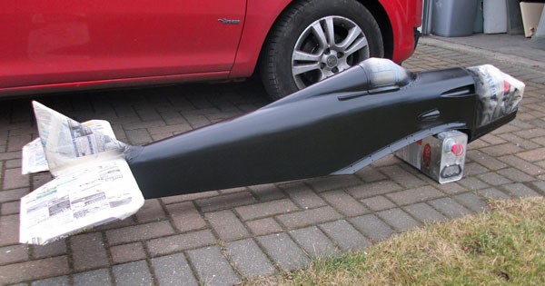

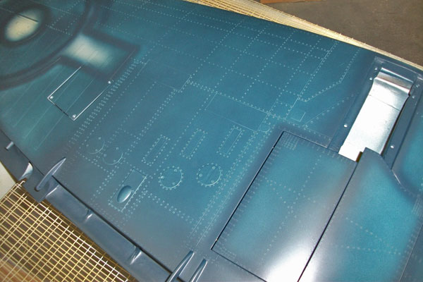

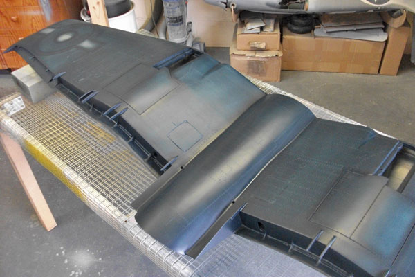

                3) DO NOT try and get the paint to cover in 1 or 2 coats (regardless of colour). This product works MUCH better being applied very lightly in
                multiple light mist coats. Not only does this speed drying time, it also reduces the amount of paint on the surface so reduced weight build up. 2-3
                light mist coats are far better & have a far better covering power than 1 heavy coat. (The 2 photos attached show a Corsair wing in US Sea Blue after
                1 coat......as you can see, a nice even finish, but you can still see the grey primer showing through underneath)

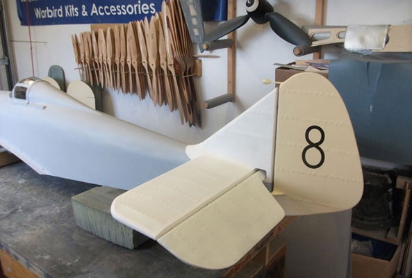

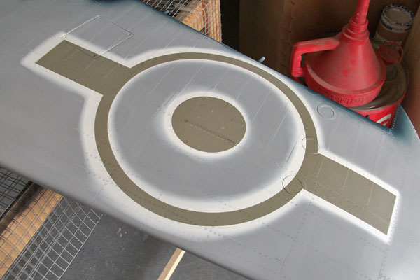

                4) Think about the order in which colours are applied......if for example you have a white marking that has to be on top of a dark colour, DON'T paint
                in this order......consider applying (as you should) the lightest colours 1st followed by the dark. White (in any brand of paint) will take multiple
                coats to cover a dark colour, so as per the attached photos, apply the light colour 1st, mask these out then apply the dark.

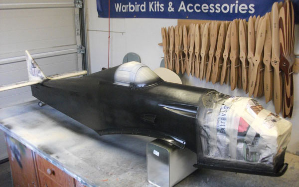

                5) WBC doesn't have to be applied over it’s own brand of primer, any solvent type primer can also be used (cellulose, 2K, epoxy, solvent acrylic aerosol etc....) So, if you have a dark camouflage, consider using a darker grey primer......if you have a light main colour, consider a very light grey or
                even a white primer (especially if you are spraying white or yellow WBC).
                The attached photos of the Miles Speed 6 in a cream & black colour scheme used a white primer on the wings & a medium grey on the fuselage.
                The wings then had 3 light coats of cream, the fuselage just 2 coats of black.
