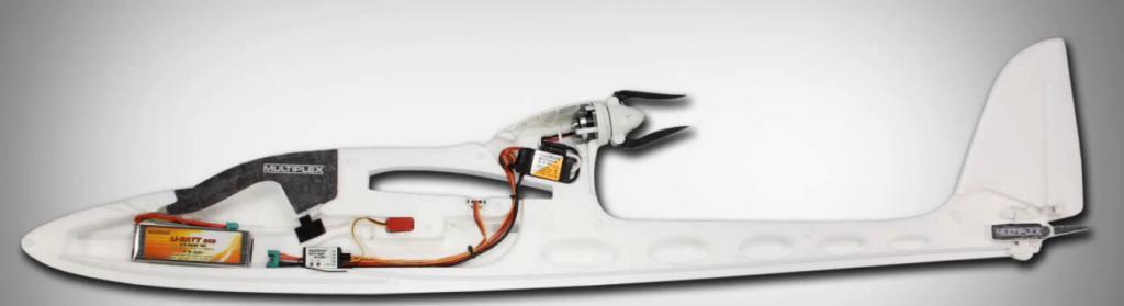

    Beskrivelse:
    Hentet fra Multiplex sine hjemmesider
    With its superb flying characteristics and safe rear-mounted motor, the new model is the ideal platform for anyone who wants to make a start in the model flying hobby. As a rugged fun machine it is also a great choice for the more experienced model pilot.
    • Powerful brushless motor - three times the power of the EasyStar I
    • Folding propeller for reduced drag when gliding
    • Easily detachable tailplane for convenient transport
    • Prepared for ailerons (everything included in the set, apart from the two servos)
    • Large internal compartment - plenty of space for a large LiPo flight pack
    The most impressive feature of the EasyStar II is its incredibly long flight times. With the recommended 2000 mAh ECO battery it is possible to rack up forty minutes of flying without thermal assistance. Fit a 4600 mAh ECO pack, and you can fly for 90 minutes, which equates to a distance of 70 km.
    Wingspan 1366 mm
    Overall length 977 mm
    All-up weight min. 700 g
    Wing area approx. 28 dm² (wing + tailplane, excl. fuselage)
    Wing loading min. 25 g/dm²

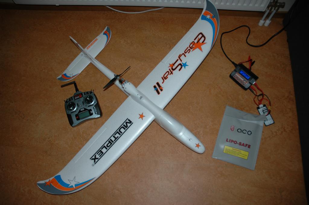

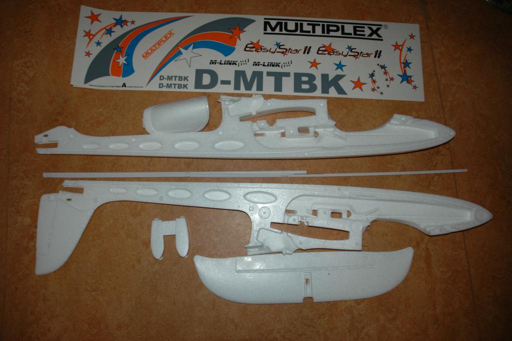

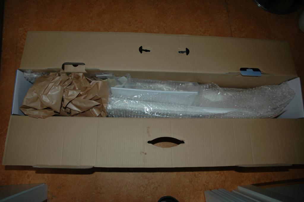

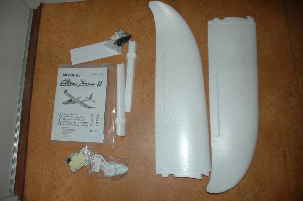

    Og sånn ser det ut når du har fått en liten pakke i posten
ID:	600899Click image for larger version
ID:	600900Click image for larger version
ID:	600901Click image for larger version
    Da mangler det bare å få det flyklart. Kommer tilbake med mer når jeg kommer i gang.

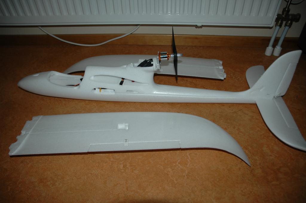

      Klar for en flyvetur
      Etter litt om og men så begynner den å bli klar. Pga for korte servoledninger til balanserorene så blir det maiden med 3ch oppsett først til jeg har de siste på plass. CG er iht manualen, 78mm bak vingkanten. Er ganske enkelt å regulere. Å flytte batteriet litt frem og tilbake var alt som skulle til.
ID:	601432Click image for larger version
ID:	601433Click image for larger version

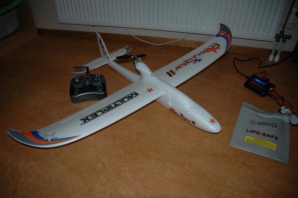

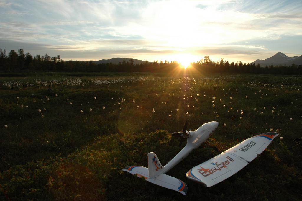

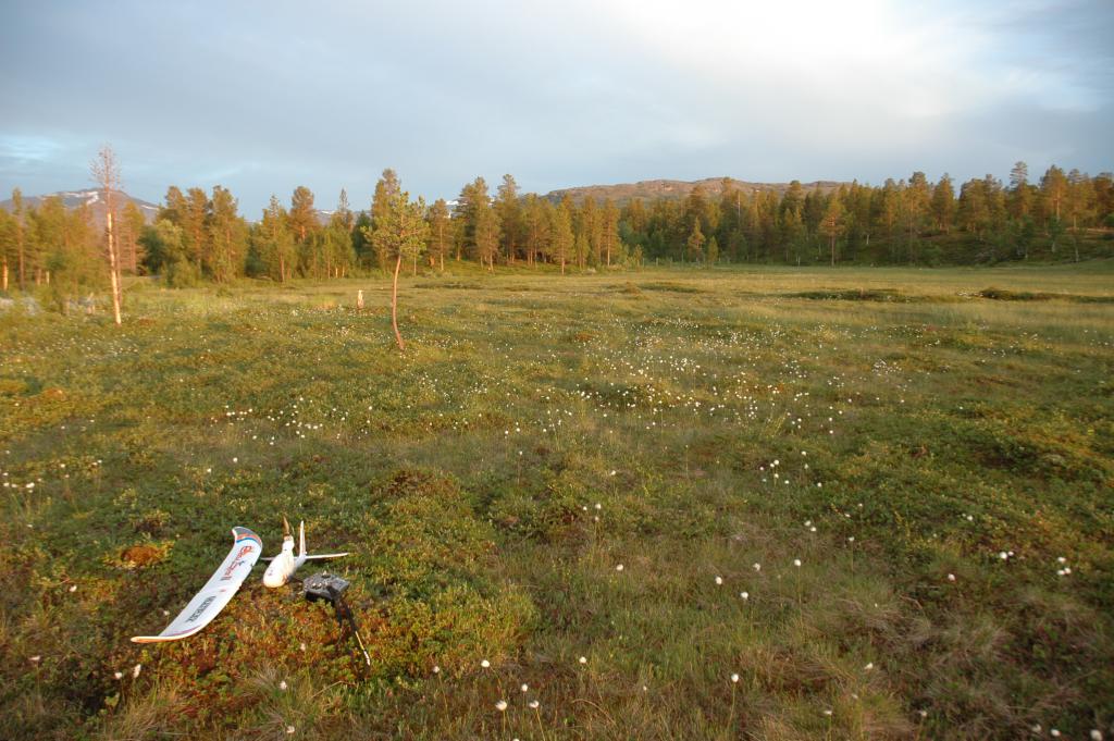

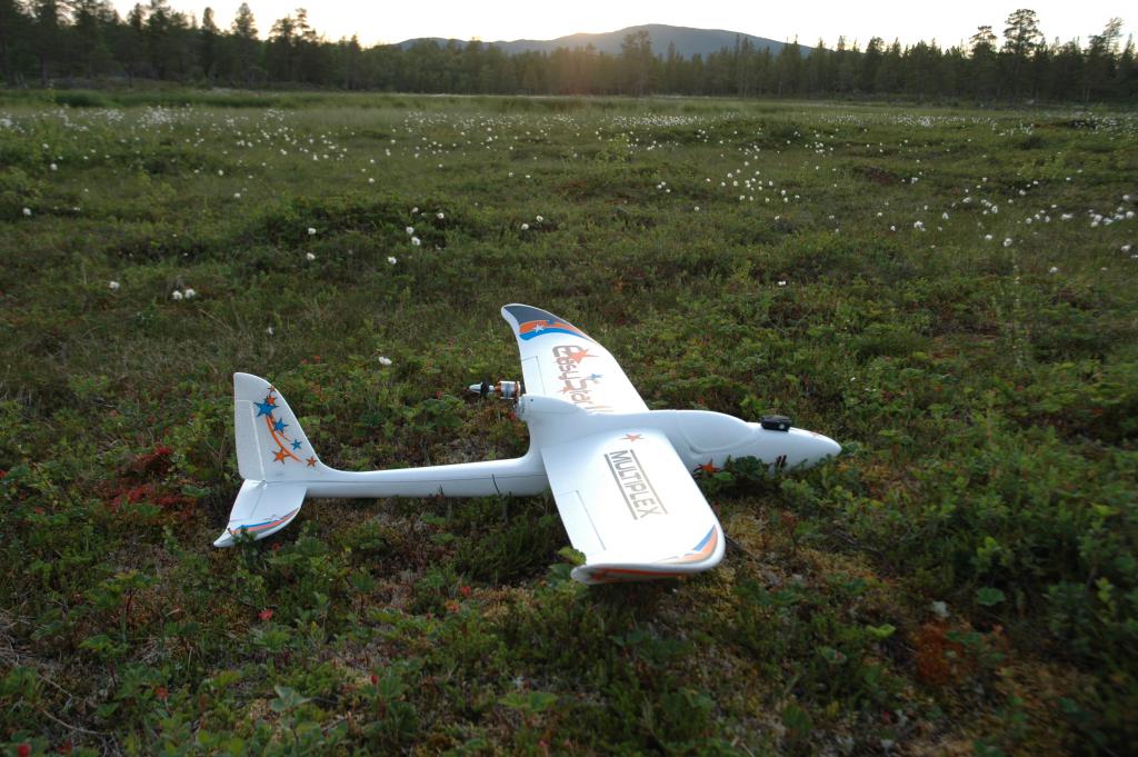

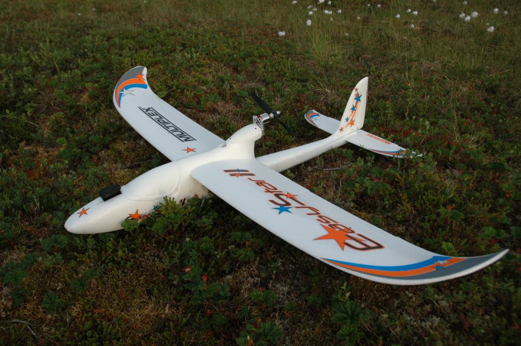

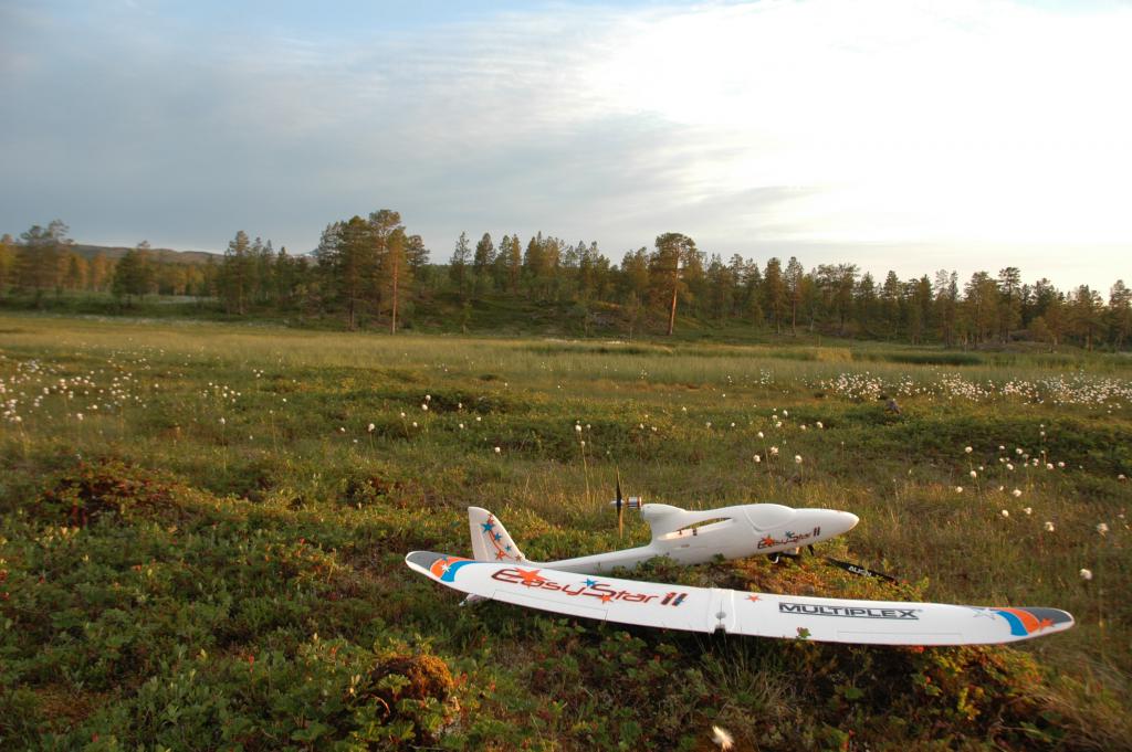

        Maiden gjennomført
        Og da var maiden tatt
        For en flott modell å fly. Selv en rusten kar som meg klarte å unngå de værste tabbene. Feilberegnet avstanden bare en gang som resulterte i en liten klatretur i ei furu, EZ II var like hel og fin etterpå men desverre så falt mitt 808 #16 kamera av i sammenstøtet og jeg klarte ikke å finne det igjen etterpå. Hvis ikke så hadde det også blitt litt youtube å dele også.
        Kjenner at jeg gleder meg til å få balanserorene opp å virke også. Vil nok gjøre det litt lettere å få pene svinger og litt bedre kontroll.
        Videre så gled denne veldig bra når man kuttet power på motoren. Jeg fikk mange landinger som gikk litt langt forbi fordi den fløt så bra.
        Alt i alt en flott 90 min i flott midtnattsol
        Her er litt bilder dere kan titte på
        .Click image for larger version
ID:	601439Click image for larger version
ID:	601440Click image for larger version
ID:	601441Click image for larger version
ID:	601442Click image for larger version
