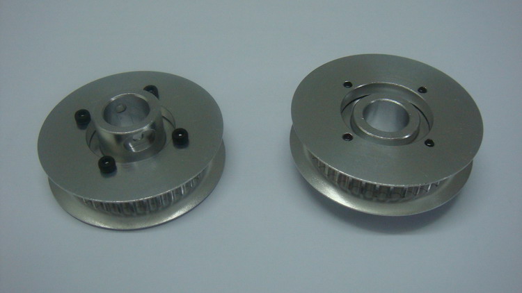

                          den nya pulley
                          The new pulley H0101-S is Z37 which is 37T.
                          We decided to increase the tail ratio a bit to improve tail performance and authority.
                          new tail gear ratio is 4.67:1
                          Old gear ratio is 4.53:1
                          Old pulley H0016-S is 36T and new pulley with screw
                          All new kits are now with H0101-S pulley.
                          We have sent all new H0101-S to distributors for replacement of H0016-S.
                          All customers from our website will be receiving our new pulley soon directly from us.

                            #88
                            Originally posted by ragge1
                            den nya pulley
                            Er det noe problemer med den gamle pulleyen, eller er det bare en ny revisjon for å gi høyere turtall på halen og dermed gjøre halen bedre?
                            • ragge1
                              • 1598
                              #89
                              noe har haft problem med de ,men så dem har forbettre sjelva pulley og hale
                              Goblin 700 : vbar 5,3 pro
