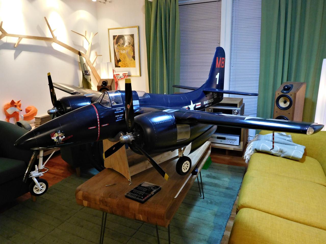

ESM F7F Tigercat.
Lurer på om jeg skal skaffe kraftigere fjærer til hovedleggene sånn at de ikke bunner ved 1 G, eller kanskje sette inn ekstra fjærer inni de gamle som tar imot fra halvveis i utskyvingen.Comment
Lenge siden denne fløy sist. Kanskje i helga. Får se hva som skjer.

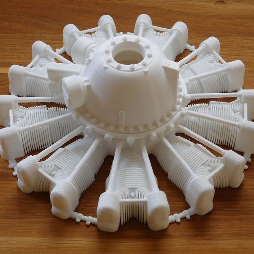

Nå har jeg lagt ut 3D-printbare filer av dummymotor og skalahjul til Tigercat (og andre med samme motor) på Cults3D.
News - 08.03.2018: I added a slightly modified front dummy engine, R-2800-04, which has a slightly larger inside diameter for better motor clearance. News - 21.02.2018: Added a backside for the radial, and a part that works as a second bank behind the first bank of cylinders. The backside can be added to the second bank piece as well and it's possible to assemble as many banks as desireable behind the original front bank of ylinders. Semi-scale model of Pratt & Whitney R2800 radial engine for rc model airplane use. Way more convincing than vacuum formed dummy engines. Designed for my 1:7.5 scale RC ESM F7F Tigercat. Diameter: 166 mm. Inside cavity large diameter: 61mm - 57 mm inside the joiner ring. The model can be scaled up or down to fit your model. For personal use only, not for resale.

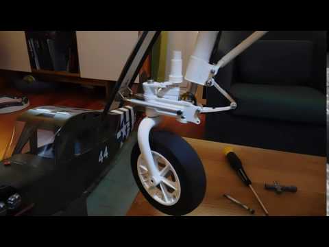

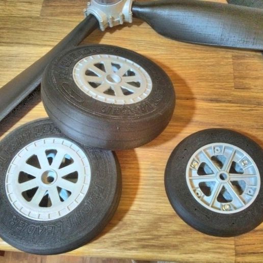

EDIT: Upgraded the design for easier printing. Semi-scale wheels for the 1:7.5 scale ESM F7F Tigercat. The parts include: Inner and outer hub halves for the main wheels. Center cap for the main wheel. Main tire. Nose wheel (print 2x). Nose tire. Video of my plane with the wheels: https://www.youtube.com/watch?v=7HlKJdslank Video of my nose wheel: https://youtu.be/uKHXzVsbTSE For personal use only, not for resale.Comment
