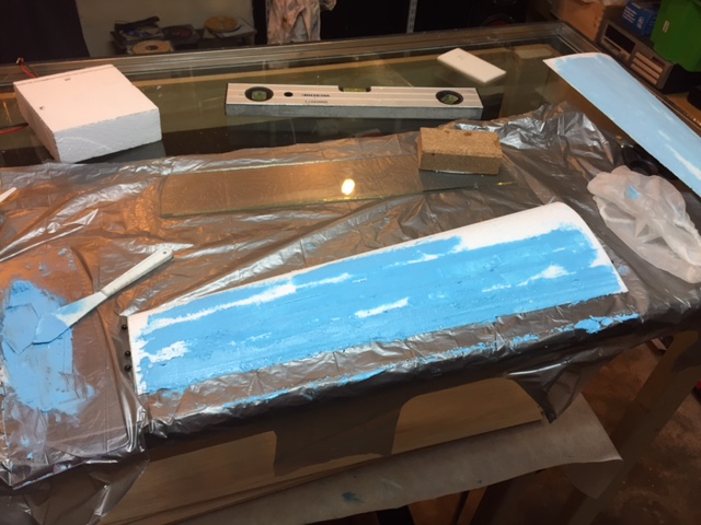

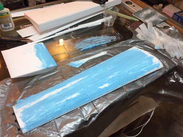

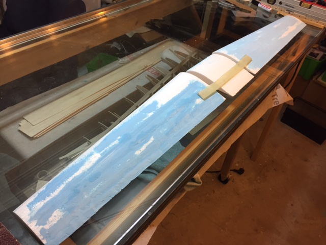

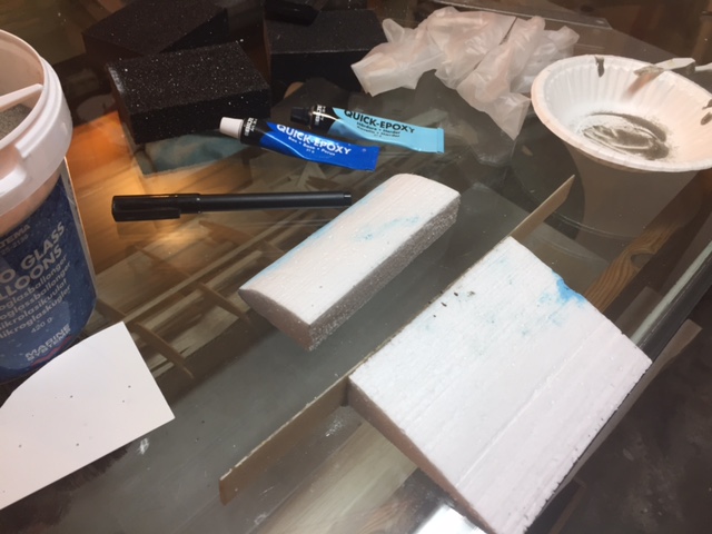

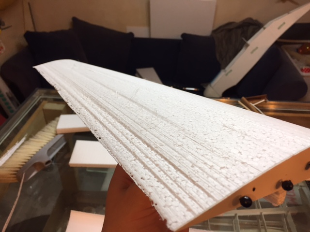

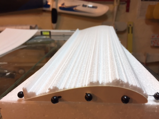

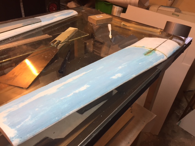

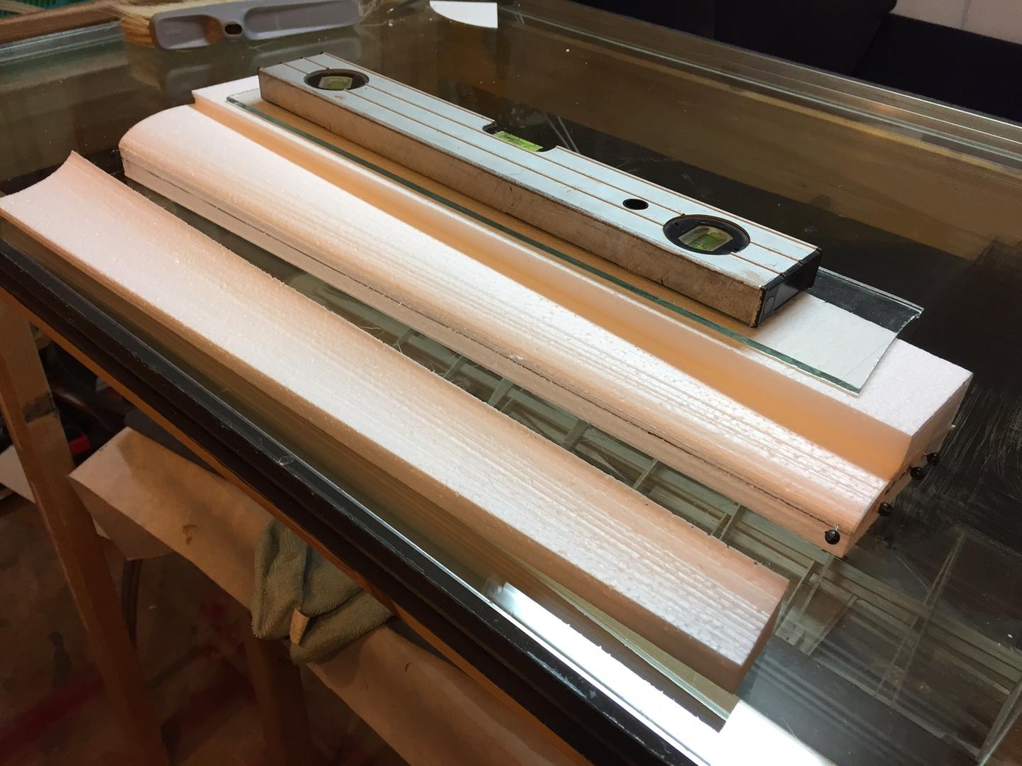

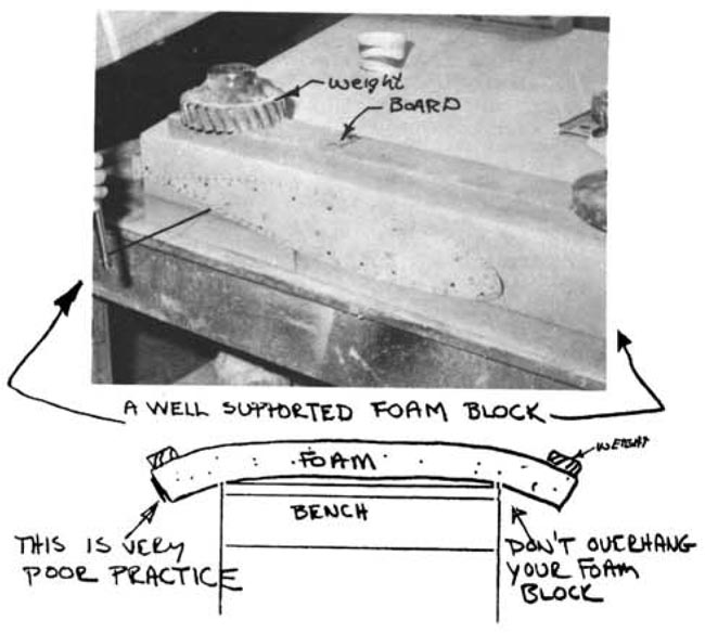

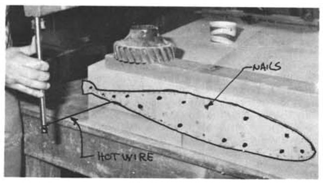

Visdomsord fra Quickie build manual (quickheads.com)

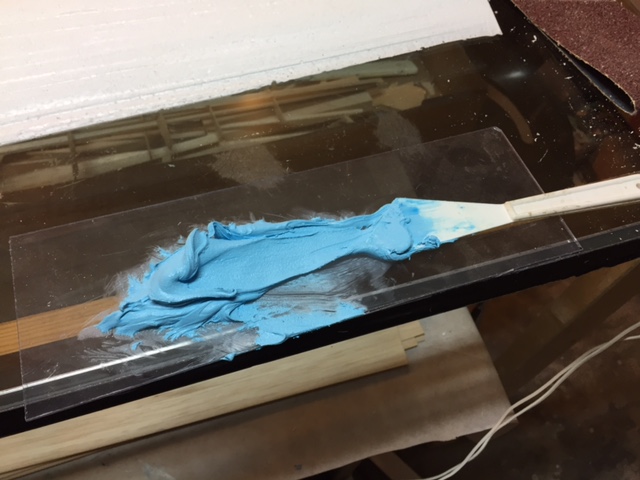

"Don’t be overly concerned if you don’t make perfect foam cuts: ridges on the foam core from inadvertently lifting the hot wire off the templates are easily faired in with a sanding block. A less-than-perfect leading edge can be blended in by sanding after the foam core is assembled. Gouges in the foam can be smoothed and filled with dry micro to contour after applying the glass skins. The foam is too expensive to throw away because of a minor gouge."
Litt pussing og sparkling med Biltema Epoxy Filler, og så blir det nok bra:

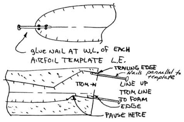

Alle interesserte bør egentlig lese gjennom Quickie build manual på quickheads.com.
Mye visdom der: http://www.quickheads.com/index.php?...&limitstart=14
