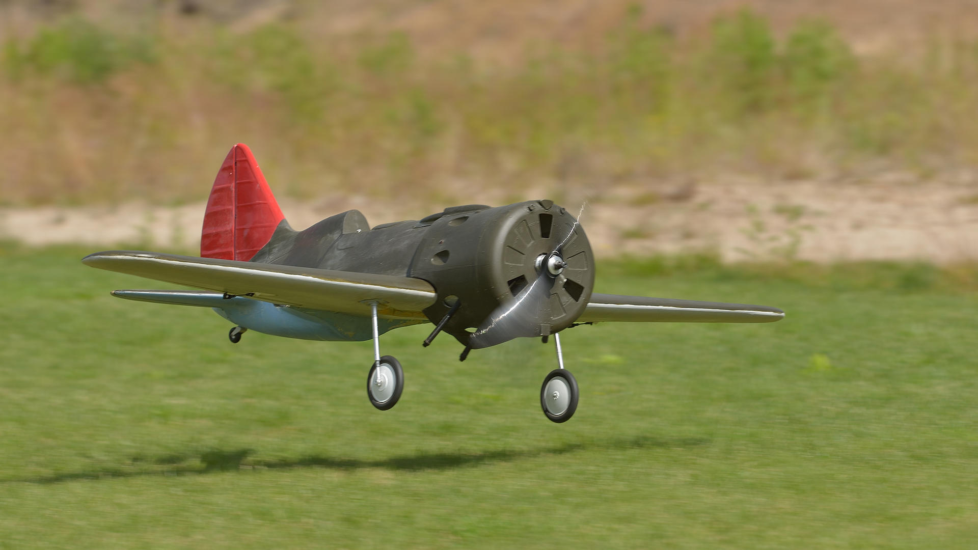

                  #263
                  Var en som tok noen bilder så har man de minnene ihvertfall
ID:	612294Click image for larger version
ID:	612295Click image for larger version
ID:	612296Click image for larger version
